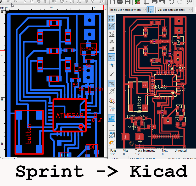

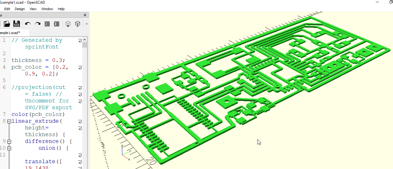

Update to v1.8: Introducing two fun new features
https://github.com/cdhigh/sprintFontRel ... s/tag/v1.8
  • Export to KiCad (with fully editable PCB elements)
  • Export to OpenSCAD (3D model)
The value of the KiCad export speaks for itself.
But what’s the use of exporting to OpenSCAD? I honestly don't know—maybe just for fun :)
  • Perhaps it could help with 3D modeling for enclosures or panels?
  • You can use OpenSCAD to further convert files to STL, SVG, DXF, PDF, etc.
  • Maybe it could be used to generate G-code for CNC or 3D printing?
  • A pseudo-3D preview of the PCB?
