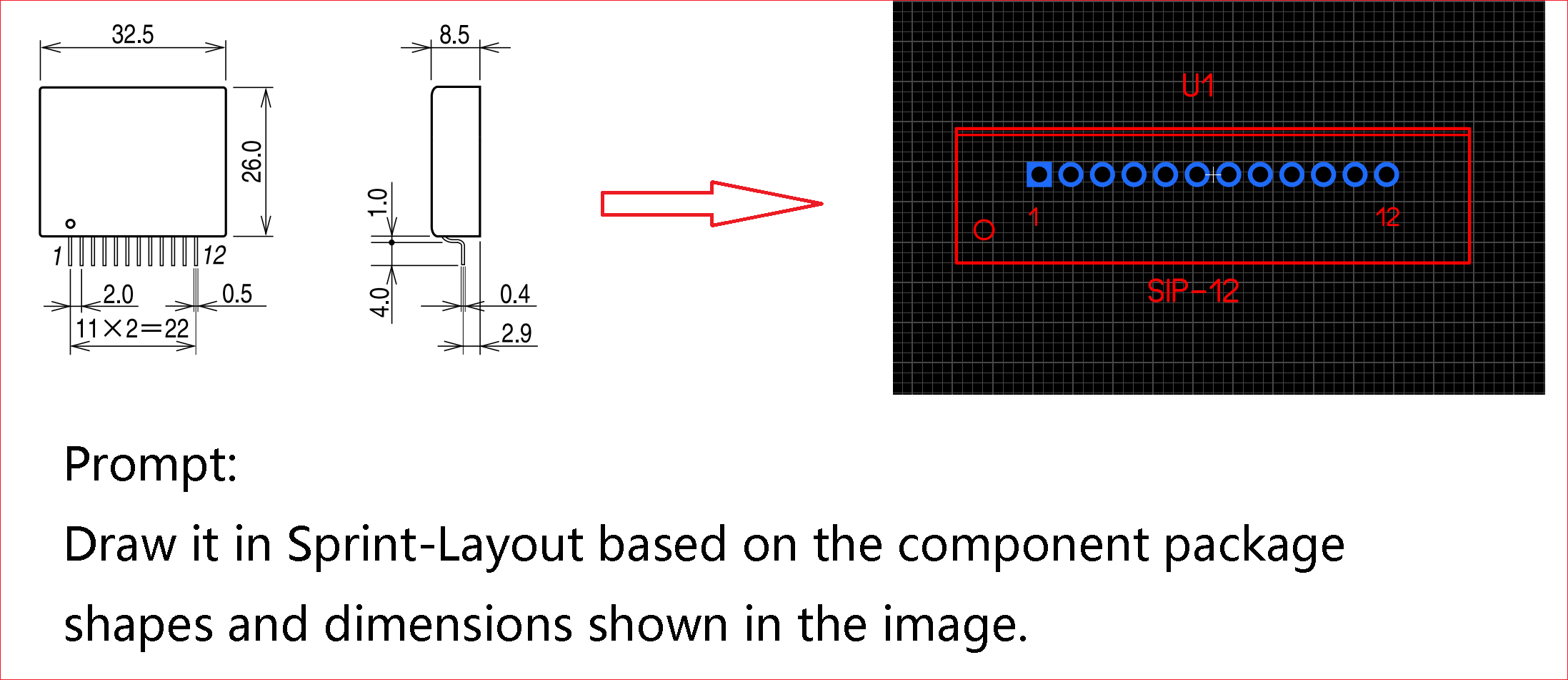

Create footprints automatically: Provide a component datasheet or dimensioned drawing and ask AI to create the corresponding PCB footprint.

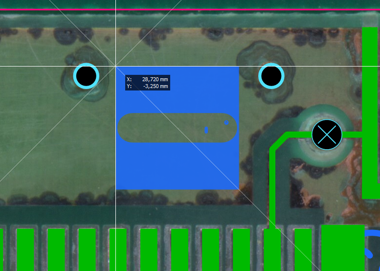

Recreate PCB tracks from photos: Provide a cleaned-up, high-contrast photo of a PCB, and ask AI to trace the visible copper tracks and recreate them in Sprint-Layout. This can help with PCB reverse engineering and reproducing existing boards.
These are just a few examples. What you can accomplish depends on the AI model, and the complexity of the task.

An example:
