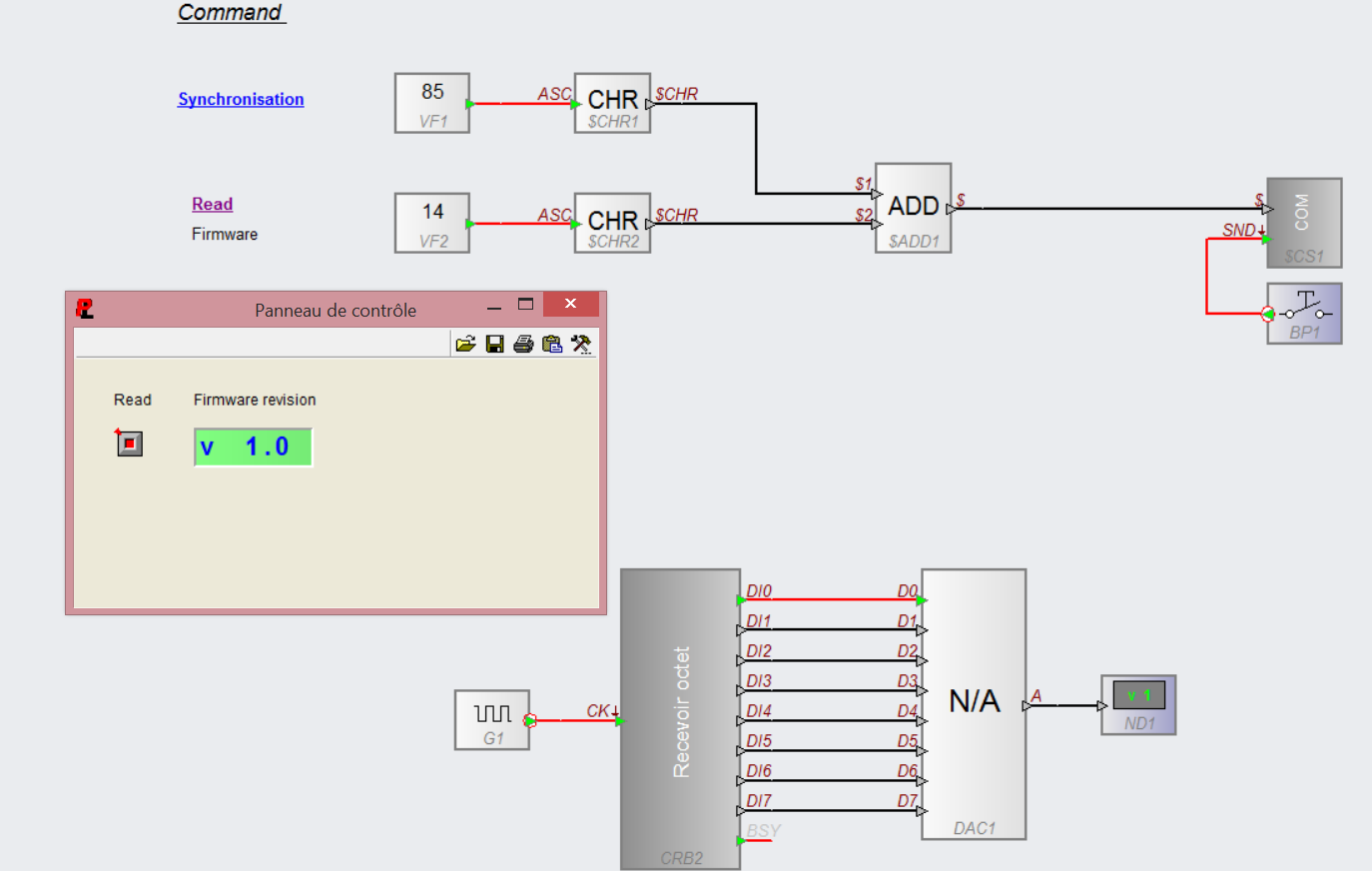

In a realization ,I use a specific module from Parallax, the motor mind B.
The protocol is pretty simple ,and i started use RS232 hardware module from Profilab EX.
In first I used the octal receiver which not include any synchro separator in the setting parameter .
But to affine my project ,where I must receive multiple octets, I started use the string séparator with chain séparator ,to divide the multiple octets out.
But at this time ,the string separator wasn't realize any reception of my module.
I check ,n° of port ,baud flux ,which is the habitual error .
But I think the separator set in the parameter ,which is the unique difference with octet receiver ,is the cause of the non reception of my module .
I tested the string receiver without any separator in the setting ,in the emitter too .
But no chains flux appear again from my receiver .
There is only read possible with the octal receiver .

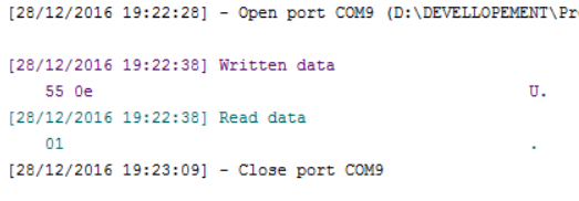

With a serial software spy ,I always see my response come after a request ,but never out of my rs232 string module from profilab expert .
I don't understand ...

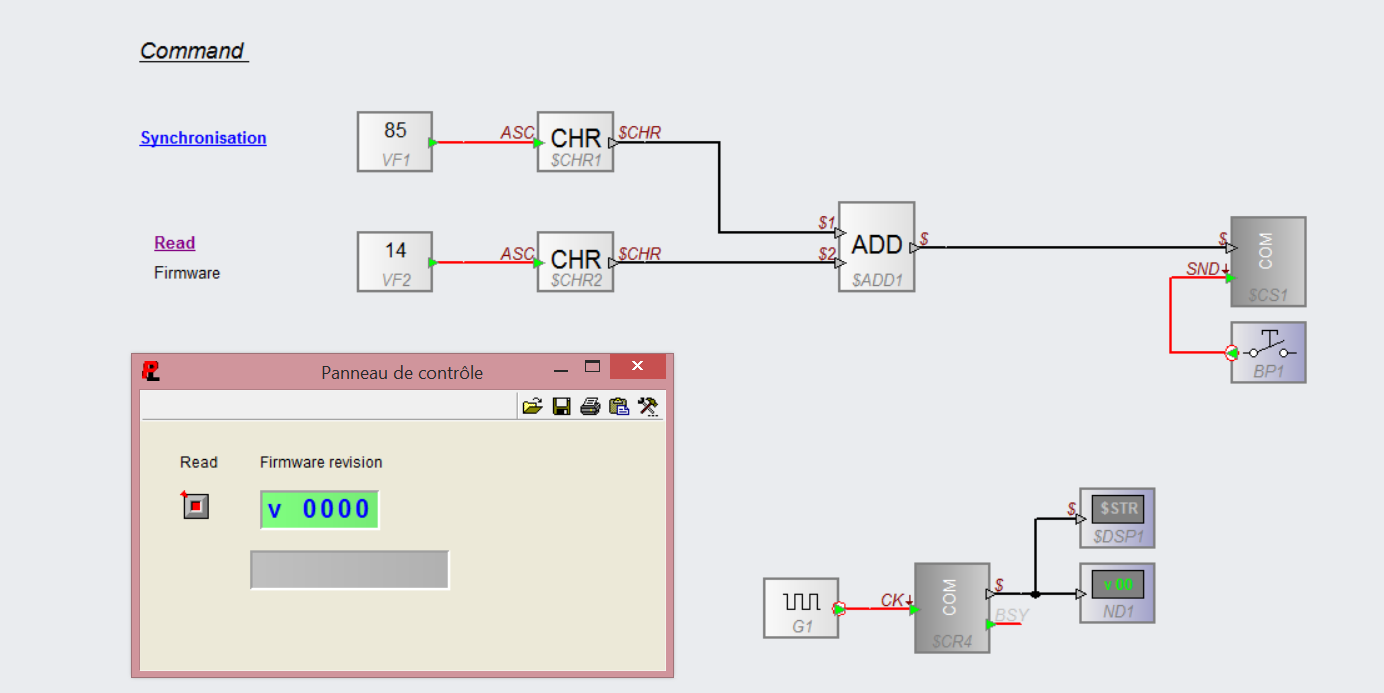

Thanks for your reply Qmesar,
I thought ,my post too much detailed ,and could give some confusion in my help request.
I do not have problem in the communication with my external device .
I received correctly my frame byte with "recevoir octet" module like the picture "Emit receive UART2"
But when I use "COM" like in the picture "Emit receive UART3" nothing come from the module, but you can see with a spy uart software log in the picture "Emit receive UART" ,my external device send his reply correctly after a request ,without any separation bytes.
I set the com module without any separation byte ,but it don't reply .
Why the com module ,without separation byte ,not reply like "octet receiver " module ?

Thanks ,for your help IKT
But unfortunally ,it's doesn't work ...
I ask myself if string com ,recognize HEX format ,
When i use octet com ,everything coming into my com port appear on the virtual pin ,without any synchro bytes.
But the protocol which i use ,employ the HEX format .
With the string com ,I have ASCII to CHAR converter ,CHAR to ASCII converter , but hex is different to CHAR or ASCII .
It's my proper thinking ,but I can do an error ....
I don't know if COM value can receive directly hex format .
The synchro byte which give me problem too ,
With octet com, no synchro byte needed ...
