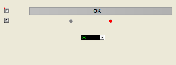

Hello ,
I'm trying to built ,an automatic program in Prflab ,for a bluetooth module.
When the module acknowledge the good protocol of command, it transmit a string "OK"
I 'm arrived to display this string ,but not compare.
I used string comparator with OK in channel A ,and string from port com receive.
I am not arrive to detect this "OK" string
Thank for people ,who can help me
Here, pictures of my problem
String comparator ,problem
- Ascii display.PNG (1.3 KiB) 10809 mal betrachtet
- String display.PNG (3.95 KiB) 10810 mal betrachtet
- String comparator.PNG (14.17 KiB) 10798 mal betrachtet

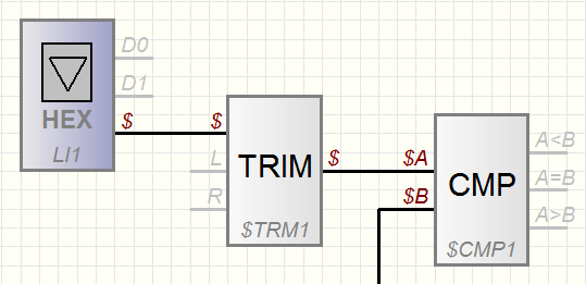

Re: String comparator ,problem
Good evening , IKT
Thank you for your help ,
I inserted this function between my Hex generator and comparator.
Without any success ...
I have put command on left and right, but nothing more .
