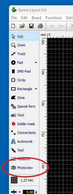

I am designing a PCB, which is very "crowdy", and I need to place the parts on the both sides of the PCB.
I have not seen a way to view the other side of the PCB, nor a way to flip from a side to the other, and vice versa: this would help to place the parts on the both side.
Can you help ?
Thank you

You can't flip the board and work with a "flipped" version.
However, you can use "Photoview" to inspect your board. Here, you can flip the board to view it from the other side.

What do you mean by "Photoview" ? : is it another software ?
Screenshot 2026-06-01 101431.png (22.92 KiB) 1126 mal betrachtet

Thank you very much !
