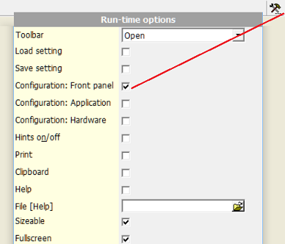

Yes, "Fullscreen" means NOT to have any window (Windows) controls. (That´s the idea of it.) This option captures the maximum available screen space, but this was never meant or tested on rotate-enabled screens. (I not even have one.) To return to a "windowed" display at run-time, you´ll have check run-time option "Configuration: Front panel", allowing to uncheck "fullscreen" in the properties if required. (Please excuse my poor English.)

Maybe it is worth improving because it is a very desirable function. The "other" monitor is not necessary for this. All you have to do is enter the video card's settings and choose the function (attached picture).
Rotation works on every monitor. Currently, I have no idea how to protect against closing, minimizing and switching off the screen application. :(
The (upper) bar still exists and is functional. Or .... add a component rotation tool to PL4. Physically, you will only be able to rotate the screen, but a recalibration such as a touch screen is a simple matter. What do you think dear abacom ;) ?
