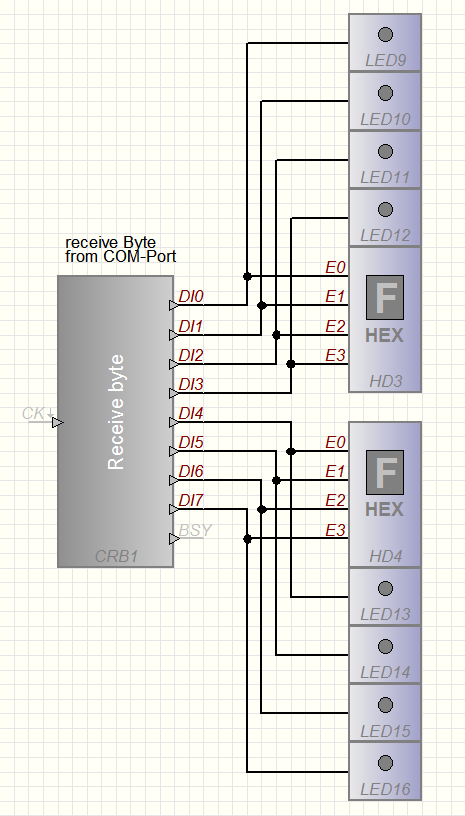

lukg20 hat geschrieben:Atmega8 send 8 bits.
OK, then use Byte receive (from COM) directly, similar to below:
HD4 is the one that is on the left hd. side of HD3 (to display the value correctly)!
Bit's 0-3 --> LOW Nibble (00-0F)
Bit's 4-7 --> HIGH Nibble(00-F0)

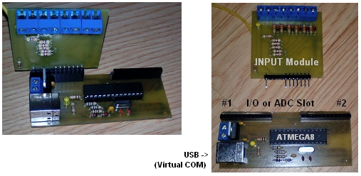

As I mentioned I am building a large project all for free. In Annex I ship ready libraries (you can see how they work). I miss even libraries input modules (I have a problem with them, () and ADC - there will be no easier.
Idea: With my designs contained PCBs and diagrams can easily create each module.
The device will consist of a motherboard and modules that can be connected discretion.
For example:
6 inputs and 6 outputs, or 6 outputs and 6 ADC inputs or outputs 2x 6 (tomorrow photos of finished modules)
He promises that everything you are provided.
Please - give me an example - I am new and do not know enough PROFILAB :(
Photo IO.JPG (109.16 KiB) 30782 mal betrachtet
