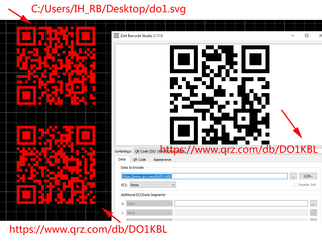

I scaned the 3 qrcode images you generated, the results correct.
Re: A plugin for Sprint-Layout, Import footprint from Kicad/EasyEDA
Verfasst: Freitag 19. August 2022, 15:57
von K-B-L
but why it looks different?
my Iphone can only scan the black one. Not the QR in Sprint Layout
Verfasst: Freitag 19. August 2022, 16:45
von cdhigh
The qrcode feature of IPhone camera is not very smart (less tolerance).
I tested with iPhone.
Found that iPhone can recognized both 2 images If I increased the grid size of Sprint-Layout to 5.08mm.

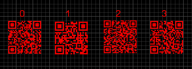

There are many parameters for QR code generation, and different parameters will produce different images, but all of them are valid.
For example, all of 4 images follows are generated from a same text string, but with the different error correction levels.

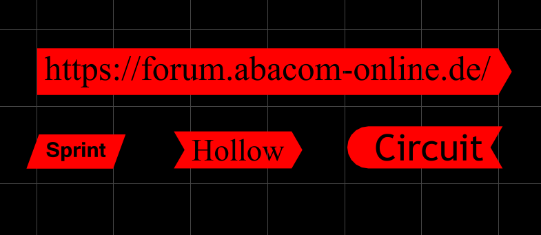

Released v1.6.
Added feature: inverted font background (negative font image).
https://github.com/cdhigh/sprintFontRel ... t_v1.6.rar

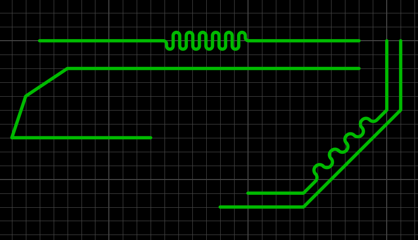

Released a new version v1.7
Added feature: Differential Pair Length Matching (serpentine trace)
https://github.com/cdhigh/sprintFontRelease/releases

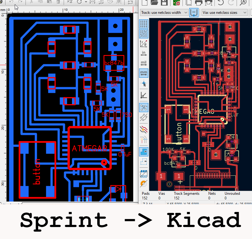

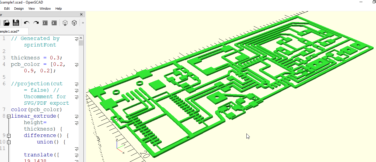

Update to v1.8: Introducing two fun new features
https://github.com/cdhigh/sprintFontRel ... s/tag/v1.8
  • Export to KiCad (with fully editable PCB elements)
  • Export to OpenSCAD (3D model)
The value of the KiCad export speaks for itself.
But what’s the use of exporting to OpenSCAD? I honestly don't know—maybe just for fun :)
  • Perhaps it could help with 3D modeling for enclosures or panels?
  • You can use OpenSCAD to further convert files to STL, SVG, DXF, PDF, etc.
  • Maybe it could be used to generate G-code for CNC or 3D printing?
  • A pseudo-3D preview of the PCB?
