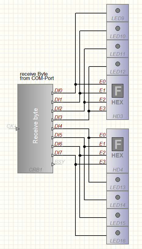

lukg20 hat geschrieben:Atmega8 send 8 bits.
OK, then use Byte receive (from COM) directly, similar to below:
HD4 is the one that is on the left hd. side of HD3 (to display the value correctly)!
Bit's 0-3 --> LOW Nibble (00-0F)
Bit's 4-7 --> HIGH Nibble(00-F0)
Zuletzt geändert von IKT am Donnerstag 27. August 2015, 10:57, insgesamt 1-mal geändert.
