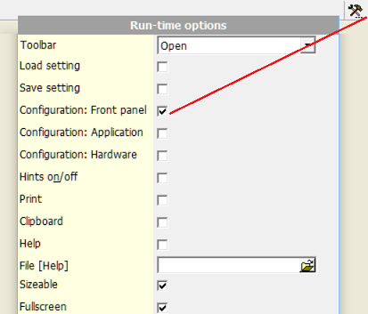

Yes, "Fullscreen" means NOT to have any window (Windows) controls. (That´s the idea of it.) This option captures the maximum available screen space, but this was never meant or tested on rotate-enabled screens. (I not even have one.) To return to a "windowed" display at run-time, you´ll have check run-time option "Configuration: Front panel", allowing to uncheck "fullscreen" in the properties if required. (Please excuse my poor English.)

Yes, I've already done it earlier. But the problem still exists.
Maybe it is worth improving because it is a very desirable function. The "other" monitor is not necessary for this. All you have to do is enter the video card's settings and choose the function (attached picture).
Rotation works on every monitor. Currently, I have no idea how to protect against closing, minimizing and switching off the screen application. :(
