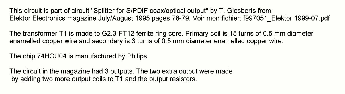

I use Splan 7.0 with the latest update installed (10.11.2021).
When I use the long text box, if I type a text manually, everything is perfect.
If I use the same long text box but I paste a text (from the notepad for example), the text is not perfect on the screen: like if the letters were not entirely black: see the attached screen capture.
Any solution ?

Beitrag von nounours18200 » Freitag 4. März 2022, 20:42
Did you copy and paste the text as a picture?
No, I copied the text from a webpage.
Then I tried to first paste it into the Notepad, saved it, (to be sure it is a .TXT format) then copied it from the Notepad, then pasted it into the long text area.
The problem is still the same.
It may be helpful if you upload your *.spl7 file here, so we can take a look at it.
Here is an example: see attachment.

Re: Problem with Text copy
Beitrag von abacom » Samstag 5. März 2022, 07:09
I can't see any real problem here.
The look on the screen may caused by the selected text font (Times New Roman).
Do you have checked the option "smooth Text" in the General-Options? This will activate a kind of antialiasing for small texts on the screen.

Beitrag von nounours18200 » Samstag 5. März 2022, 18:56
I have just check it: yes it is activated.
I have tried with another font, Arial for example, and the problem is the same.
Well it looks like some letters are not entirely black, or like a text typed on a type writing machine with an old tape...
I have tried with the demo version of Splan 8.0 and this issue is not present: The text is perfect on the screen, with the same font and the same size... look the attachment.
Beitrag von abacom » Sonntag 6. März 2022, 09:45
I think this is only a problem of how the text will be displayed on your monitor. What if you are zooming in? I think the text will be looking better then. A monitor often has a quite small resolution (dpi), and so there are several techniques to display small text as well as possible on a monitor. One technique is the anti-aliasing. This anti-aliasing is better in sPlan 8.0 than in sPlan 7.0 and so the text may look better here. But remember, this is also a displaying-issue on your monitor and not a bug in sPlan or in your spl-file.
