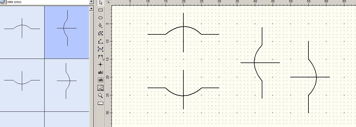

You can also create the symbol manually and then insert it if necessary
1) create a broken line and a continuous line that crosses the first line
2) Use the Bezier curve function and create a curve/semicircle between the two parts of the broken line
3) mark the construction and create a new component from it and add it to a component library
4) If necessary, rotate the construction and also save it in the component library
