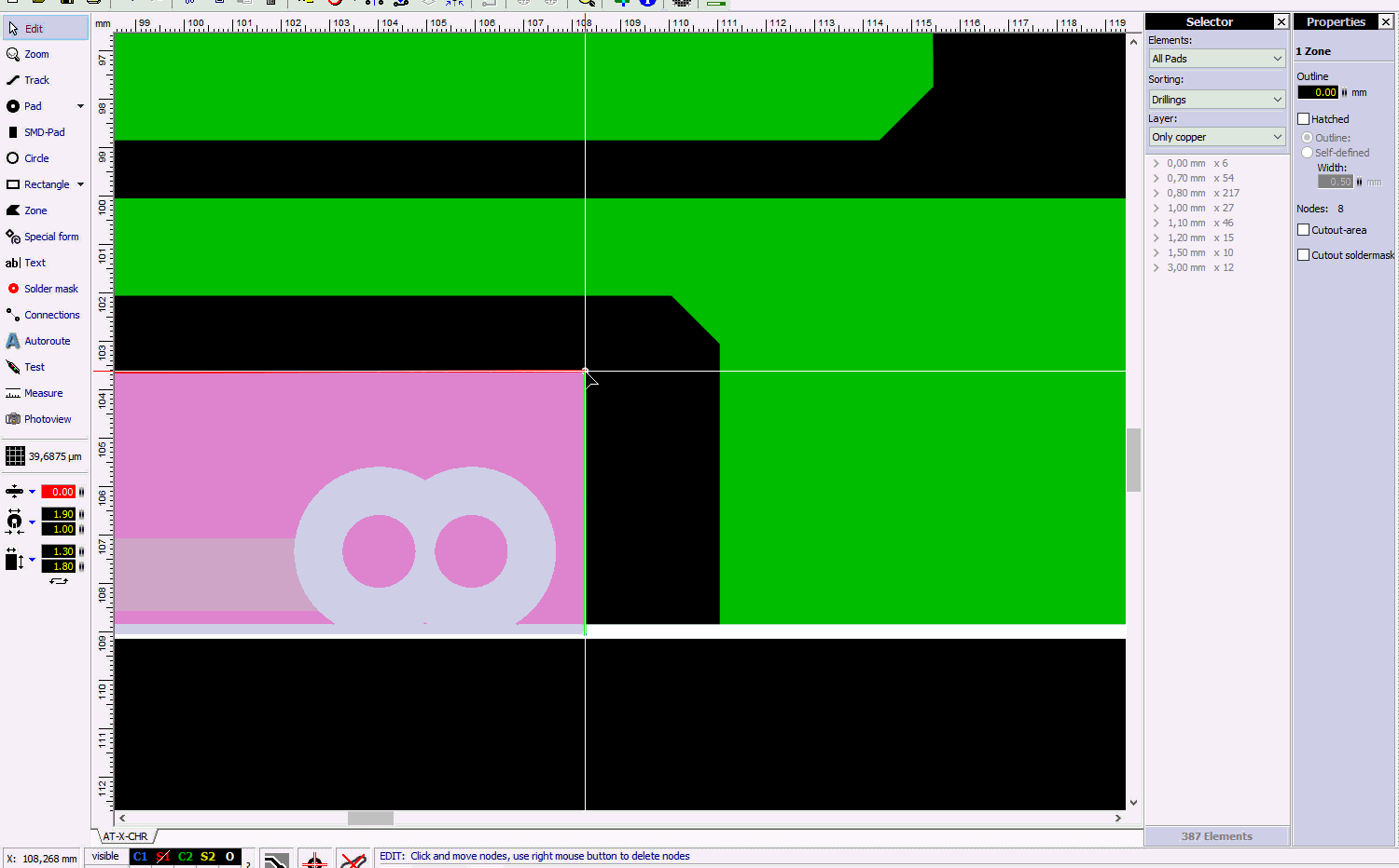

The alignment green indicator does not work correctly in zone drawings. Scroll 3 steps, indicator is still green. There is no problem with track drawings
added .GIF animation

This is not a different behavior between track and zone. You must know, that there is a little tolerance which shows the line is either green or red. You have a very small grid, and if you have e.g. a long horizontal line and you move one node of this line 1 or 2 grid steps in vertical direction, then the effective angle of this line is still so close to 90° or 45° that the line keeps green. No matter if the angle is 45° or 45,02° or 44,98°.
