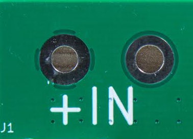

Can we have a new type of pad in an updated version 6? The type of pads are these, which I think were produced in KiCad:
The through hole on the left connects to the copper plane, the one on the right is insulated from the surrounding copper plane.

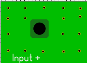

The only way I can find to produce something similar results in this isolated pad, which is awkward and time consuming to produce:
Am I missing a trick? It would be so much nicer to have a round pad available, without having to produce a zone around a hole.

That looks good, unfortunately the area in question is not a ground area, it is within a self drawn zone and connected to input +Ve with vias to a similar zone under the PCB (a high current copper area).
