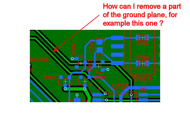

I would like to remove just a part of the ground plane, or define an area in which there is no ground plane : look at the attached photo.
How can I achieve that ?

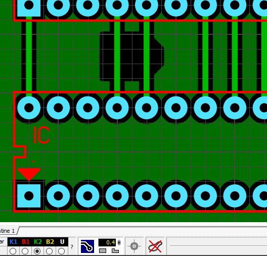

At the bottom, where the auto mass is activated, there are two icons for rectangle and polygon. With these you can draw blocking areas for the automass at the desired position.

Thank you very much Hal90009: this is exactly what I was looking for !
