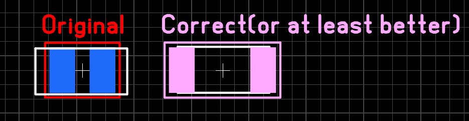

The 2512 SMD resistor is wrong. The dimensions of the resistor is 6.4x3.2mm according to this table:
https://www.rohm.com/electronics-basics ... ifications
But it doesn't fit:
Screenshot 2022-07-25 144903.png (21.37 KiB) 5641 mal betrachtet

The UPDATE does not touch the component library.
We have already corrected this wrong macro, but this will only take effect for new customers who bought their licence after we have made this correction. Anyway, thanks for your hint.
