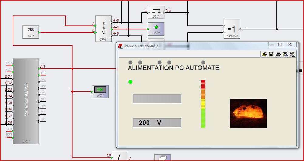

Re: Analogic comparator , A=B don't work when E1 and E2 equal !
Thanks for your reponse ,
I give you a picture part with 2v on A consign ,and you can see on the numeric meter ,2.0V ,and A=B don't appear.
- comparateur analogique.JPG (71.27 KiB) 15990 mal betrachtet

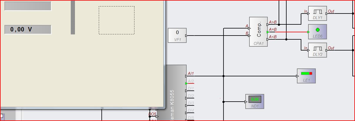

It's working good !
I turn my Analog input from K8055 to a 0v value ,and enter in the analog comparator a 0 value .
But how to work with another equal value ,if i desire enter a consign more high as 0 , like 1 , 2 or more ?

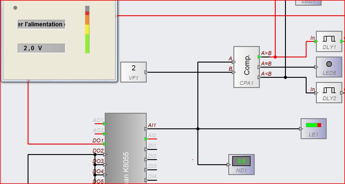

Hi Tourneur,
you should clean (delete) the crosspoint between input A and B of the comparator.
The output fom your K8055 will be added to both inputs (A and B) - so, never you will get an equal.
Greetings from
TSD
Greetings from
TSD
I do it ,
So it's work ,but for pair consign number only ,like : 2 , 4 , 6, and 8 .
And not for the impair number like 1 , 3, 5, 7, and 9.
And it's the same thing for their multiple : ok for 20, 40, 60 and 80 no for 10, 30, 50 , 70, 90, and it's not working too for the no-decimal number ,like : 2.1 or 21 , 22 ,43 ,etc ...
- comparateur analogique 3.JPG (71.14 KiB) 15878 mal betrachtet

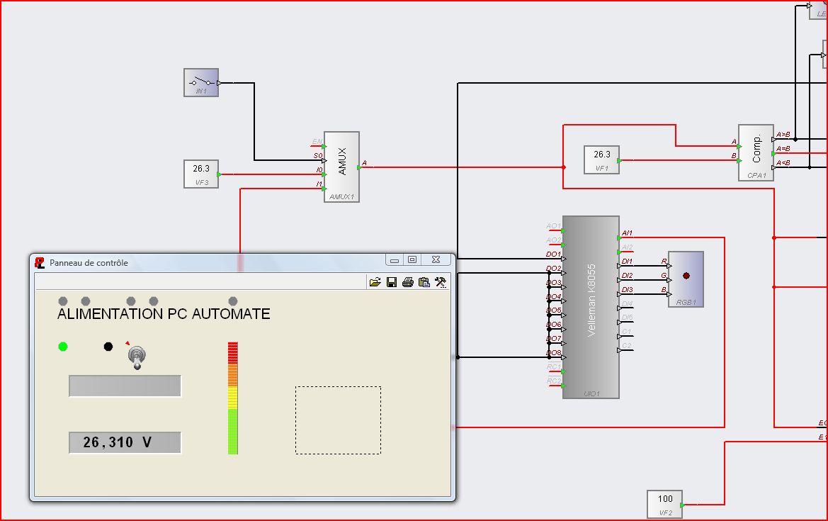

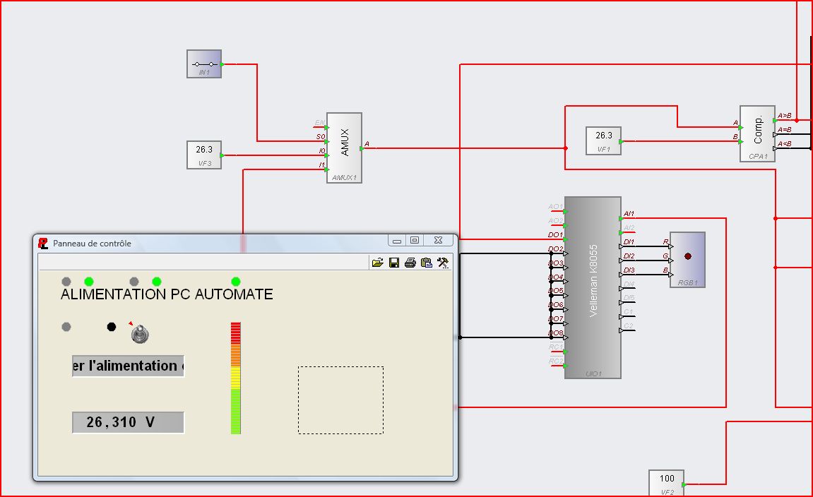

Hi evrybody !
Thanks a lot ,for you interest ,so I had test a new shematic ,
It 's include an electronical selector ,betwen my K8055 interface witch giving me 26.31 analogue value
With your help request ,now I use a 5 digit display ,and to compare ,if it can be an error ,of my wiring ,I use a fixed value of 26.31.
I,the last to command the selector a simple switch select the fixed value ,or my k8055 value .
So the result the same : there no fonctionality with my external interface .
- with k8055.JPG (86.36 KiB) 15200 mal betrachtet
- without k8055.JPG (85.67 KiB) 15112 mal betrachtet

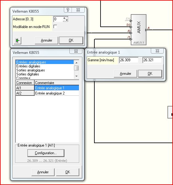

So now ,I see problem witch is in my configuration interface, or I don't know where .
But You can see my K8055 ,first analogue input configuration "AI1"
You can see ,I had get two min / max value ,with 3 unity after 0 to can get a best accurancy (in thinking ,my problem ,can be here )
- K8055 configuration.JPG (60.89 KiB) 15204 mal betrachtet
