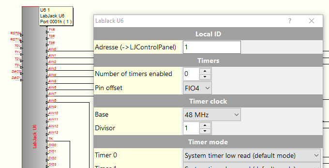

We are using a LabJack U6 and it is working very well when I use the Green Arrow button to simulate my program before compiling it. The U6 is connected via USB. When the program run in simulation mode the Green LED is blinking on the U6 and every things goes well but when I compile the program and run it, the program can no longer communicate with the U6. The Green LED do not blinks on the U6.
I was trying differents U6 adresses but no result. I rewrote a new adress in the LabJack U6 with the aid of LJControlPanel but no result at all.
What can I do to solve the problem ?
