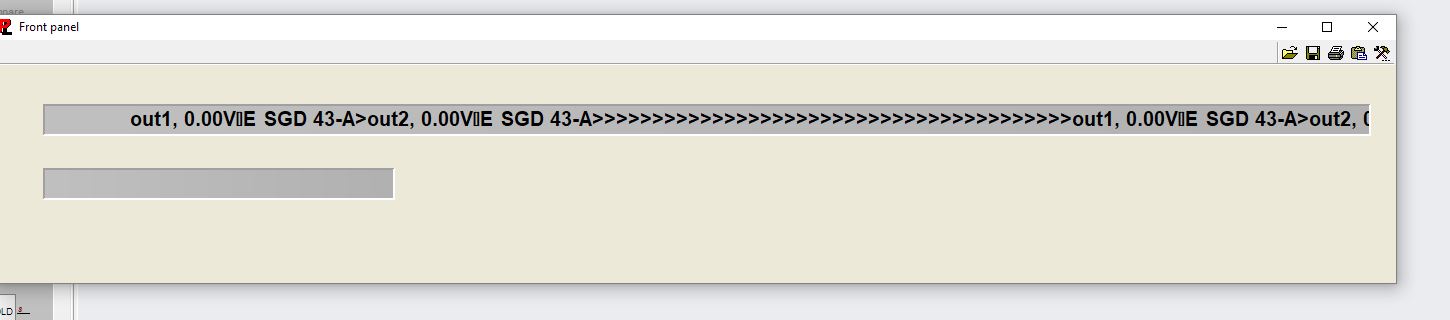

The other thing is I’m not displaying the data I should be.
Attached is an image of the data it sends when reading through a terminal and then what is being displayed in ProfiLab.
I’m not sure why the out voltage is so different. Is it to do with reading it in as a Byte?

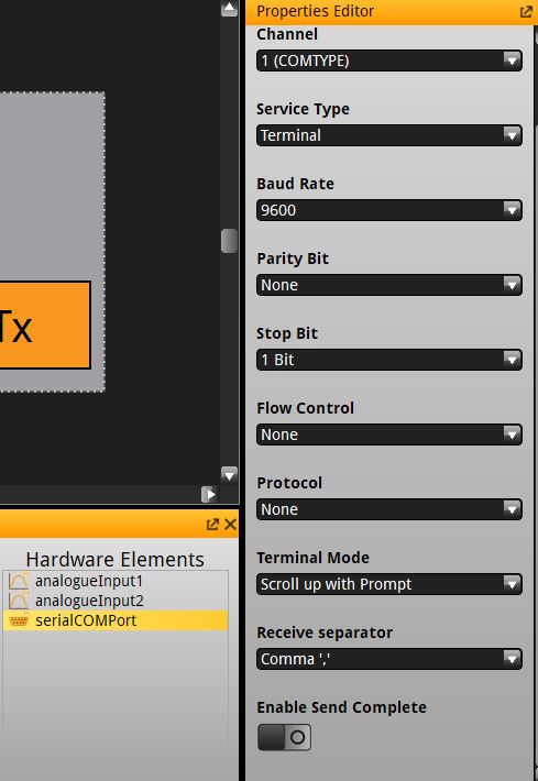

Thank you both for your responses.
I have contacted them before and you are correct in saying that they provide little explanation about the products interactions outside of its own property.
You are also correct that I have set up the device myself, and have attached an Image of that.
There are two values then being sent, the first being prefixed with out1 and the second out2.
There is a slight update.
Program as it stands is trying to read the data from the device and then send it back to it.
I had the sending data working but having just disconnected it and realized that that had been interfering with my receive data.
Now when I send, it sends the data bit by bit to the buffer as shown in the attached image.
Ideally what i would like to do is split and sort that data into the V for out1 and the V for out2 and send it back to the same device.
But as I said whenever I try to use the send and the receive in the same program here my send data is fine but my receive gets very messed up.
I will attach a section of the project because I have a feeling that there is something very basic that I am being wrong here. Perhaps in how I am trying to process the data or just even how I am Using the CLK.
Thank you again for your help, I am quite new to this software so please excuse the basic mistakes.

My apologies,
The image of what I was reading in ProfiLab did not attach.
It is here.
It is here.
- bs.JPG (44.27 KiB) 13411 mal betrachtet

Re: Panel Pilot - SGD 14A - LASCAR ELECTRONICS
So you receive a readable string with some field separators in it. That´s fine!
Please refer to the ProfiLab RS232 "GPS-Demo" example, which has similar requirements.
It shows you how to receive a string (with all fields in one go), how to separate data fields with $Part component and how to filter certain channels. Looks like ">" is the line (sync) separator and "," is the field separator, right? (There may likely be a chr(13) chr(10) for line end sync as well?)
Good luck!
Good luck!
