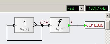

It is "send byte" module, but I can't find how to send chars with speed more than 1 k/second - the maximal rfiequency of generator is 1 kHz only.
Beiträge: 529
Wohnort: Elbe- Weser-Dreieck
Re: Com String empfangen
Beitrag von Mike D » Donnerstag 9. September 2010, 16:46
A digital inverter, output connected with input, will produce a clock with half the simulation frequenc. Fast enough?

Don't think so. If I have 1 kHz or slower emulation friequency, I can't obtain 1 kHz or more from Your scheme.

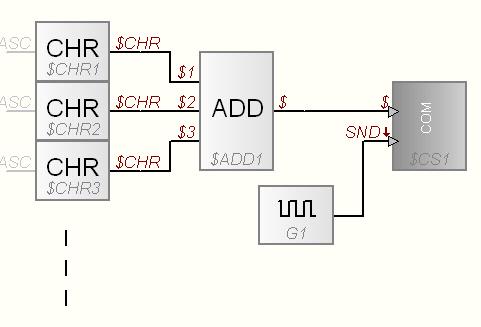

Can I use the structure to send, for example, char array 0xFF 0x0F 0x00 0x00 0x00 0xFF 0xFF 0x0A ? Zeroes can be send with this module?
no problem!
