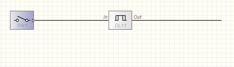

Hello everyone, I need to create a delay in switching off into infinity.
What object can I use?
I need that when a signal to the delay he turns on and remains active in an infinite way.
thank you Regards

Hi Millman,
I guess this is what you need: simply use a flipflop to store an event.
Regards:
Thomas
