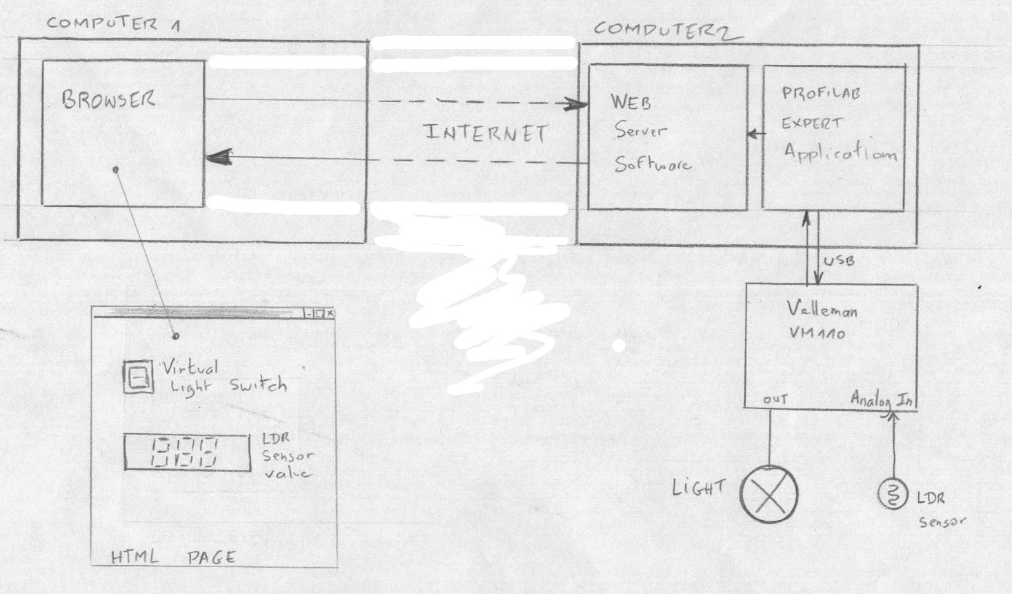

I'd like to realize one project using WEB SERVER with my students (A simple one for the moment) :
Switch On a LIGHT via the internet and verify with an LDR sensor that the LIGHT is correctly on (I join the schematic diagram).
I'd like to present this project to a team of teachers to show them the possibilities of PROFILAB EXPERT and WEB SERVER.
I'd like to realize a complete pedagogic ans ressources file to help teachers.
I realized (basic) my local application.. no problem in a local configuration (I join my program)
But I don't know how to go on to transfer my application to another computer ..
HELP needed........

DIAGRAM
