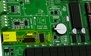

Hello Team.
I am using Profilab for a few years and did many project with micro controllers and Profilab interfaces to the mcu's over serial port and now using an FTDI USB translator chip and serial,
However I am designing a new PLC controller which uses a PLC board with an Ethernet interface as shown in the attached photo and I would like to ask some information about PL4.0
(1) is it possible to use the PL4.0 TCP block to interface PL to my mcu in UDP
(2) what possibilities does PL have to do such a connection
(3) any idea how I can use PL with this Ethernet port on the PLC board
I appreciate any help or comments
Best Regards
Peter
