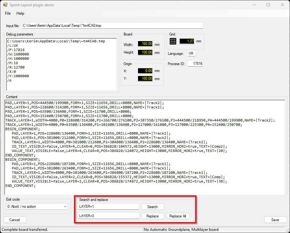

I've added a search and replace (all) option. You can for example replace layers in one go or make tracks thinner or thicker in one go:
2023-12-10 16_23_42-Sprint-Layout plugin demo.png (55.84 KiB) 4692 mal betrachtet
