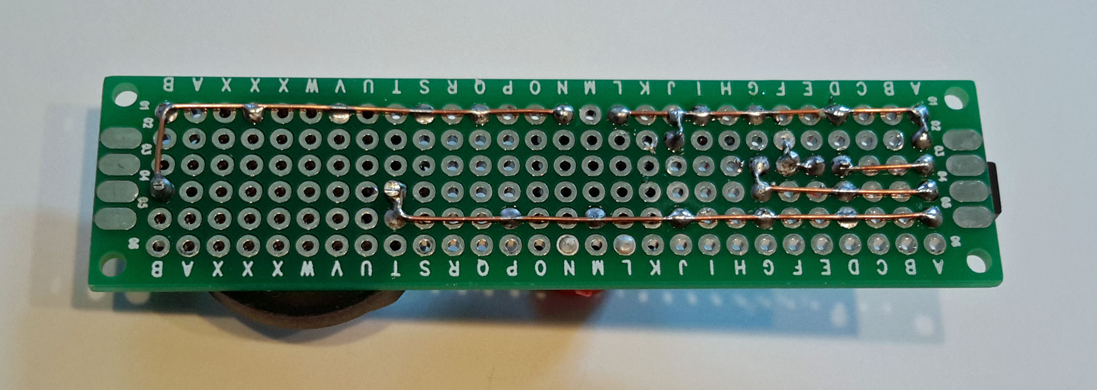

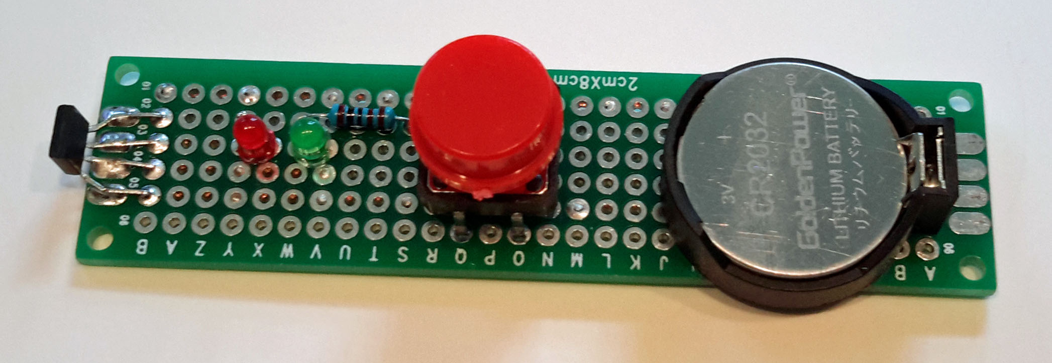

A very simple but very useful magnet tester.
A North-pole in front of the APX9141 makes the red LED light up
A South-pole makes the green LED light up.
I bought the APX9141 very cheap on ebay (about 4€ for 10 pieces).
Magnet Polarity Tester

- Magneet polariteit tester (front).jpg (203.54 KiB) 12654 mal betrachtet
- Magneet polariteit tester (back).jpg (257.98 KiB) 12654 mal betrachtet

I've added the simple circuit diagram with measures for the sensitive area.
The question is whether parts are currently available from China...
Groetjes Bernd

Hi again,
I found in a dutch forum https://www.circuitsonline.net/forum/view/130127 the problem, that one of the LEDs is always on (also without any magnet) because of the latching outputs. Can you confirm this?
Bernd
Bernd
Hougaarden
- Beiträge: 45
Re: Magnet Polarity Tester
Bernd,
You are absolutely right about the latching outputs. You can avoid this by using two 3141 Hall sensors next to each other, one with the text in front and the other with the other side in front (the front detects one pole, the back the other).
If you are in a hurry to get a APX9141, I can send you one ore two by mail. Just send your address to my e-mail box (hougaarden@hotmail.com)
Regards, Wilfried
Regards, Wilfried
