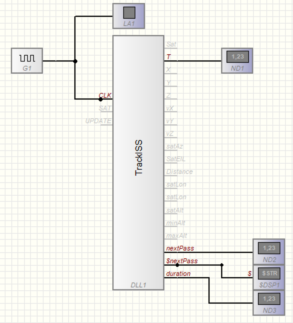

Thanks for your comment. For my regular projects I use only PL, but in this case I'm working on a satellite tracer.
Special for fellowing the International Station ISS.
To calculate all relevant information I needed to write a dll. This one is working fine.
One thing gives me an enormous problem that is converting the time string into the right format needed for PL.
Thus still open the question to help me to convert this one.

In DLL's for PL, String outputs must be "labeled" with a $ sign, prepending the Pin-Name:
Not: "T", but: "$T" ... this is equally true, for String inputs.
You might want to use a "static String" to keep the string, until the next CLK.
(you have to, however, copy it on every occasion, the dll code is executed,
independent of CLK state)
Then the created String in DLL must be copied to "PStrings", not "POutput".
Use only CCalculateEx(), whenever you're dealing with Strings.
