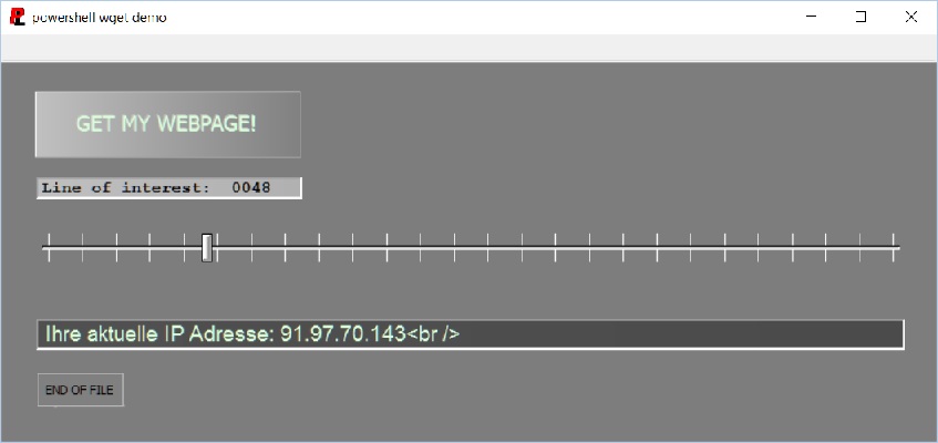

Re: Arduino e webserver
Verfasst: Freitag 24. Juni 2016, 09:40
I just tried to "Execute"... a "GetMyWebPage.bat", triggering a powershell wget command:
Code: Alles auswählen
powershell wget "http://www.meine-aktuelle-ip.de/" -outfile "MyContent.txt"
...and pick a line of interest from the resulting "MyContent.txt" .
This works fine on my WIN10x64, but I´m not very familiar with the powershell and the wget command(s).
https://de.wikipedia.org/wiki/Windows_PowerShell
Here is the project...
WebGet.zip
(4.06 KiB) 755-mal heruntergeladen
