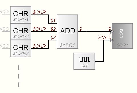

It will be good to have some kind of module, that can send unsigned character array.
It is "send byte" module, but I can't find how to send chars with speed more than 1 k/second - the maximal rfiequency of generator is 1 kHz only.

Can I use the structure to send, for example, char array 0xFF 0x0F 0x00 0x00 0x00 0xFF 0xFF 0x0A ? Zeroes can be send with this module?
Re: Com String empfangen
Verfasst: Freitag 10. September 2010, 13:36
von KAKTUS
no problem!
