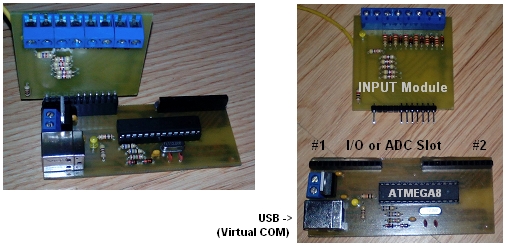

Hello.
They're working on the device inputs and outputs USB-based microcontroller Atmega8. Share when I finish.
The unit will consist of modules that connect to his own personal experience bath.
When you create macros encountered a serious problem with access.
With RS-232 I get the value HEX 16-bit microcontroller input ATMega8. I can do so that the LEDs in the program work in turn. In the example I posted the switches that send HEX values corresponding to those of my microcontroller (do not start at the same time!). The practice can also be combinations of switches so HEX values must be literally translated output LEDs. Please help.

I do not have the source code Atmega.
Atmega sends the states of pins (pinc) in the form of HEX values (FF or 3F or 00 or 01 or 08 etc ....) I need to decode them into such a form that the LEDs in PROFILAB match will enter the Atmega8. When decoded hex (attachment 1 Post) into binary form LEDs light up in a different order (depending on the combination of the input states). They need to map input Atmega8.
This will be the input module in my project.

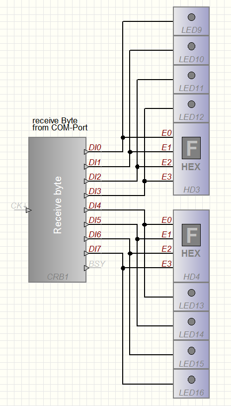

Re: input HEX to program LED ATMega8 - Help ME
OK, then use Byte receive (from COM) directly, similar to below: HD4 is the one that is on the left hd. side of HD3 (to display the value correctly)!lukg20 hat geschrieben:Atmega8 send 8 bits.
Bit's 0-3 --> LOW Nibble (00-0F)
Bit's 4-7 --> HIGH Nibble(00-F0)

So everything is OK.
The problem is your simulation of the Atmega inputs, because you set there decimal 10 instead of hex 10.
I think you misinterpret the result shown by the windows calculator.
bin hex dec
000000 0 0
000001 1 1
000010 2 2
000100 4 4
001000 8 8
010000 10 16
100000 20 32
Oh, the solution is so easy.
please enter $10 in $CNST2
and $20 in $CNST1 then your HELP ME.projekt works fine.
The $ makes PL to interpret the values as hex.
