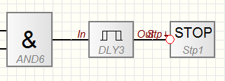

I'm being driven crazy. Every time I use the SIMULATION STOP function in a project I get 'random' stops as soon soon as I start. If I can get the project started then everything works fine. I have tried various modules like SWITCH DELAY in front of SIMULATION STOP so that the signal has to be valid for sometime. This must be a problem that has been solved! Thanks

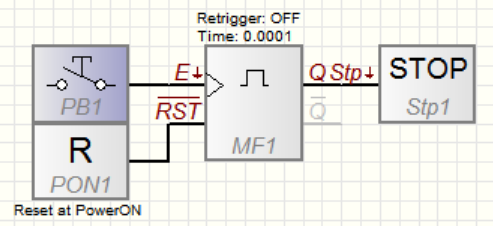

I think, the logic you're using, is the wrong way around ...
Instead of a "Delay", use a "sharp trigger", see below.
Also, make sure, to reset the Mono-Flop, on SimStart.
a "sharp trigger" - to Stop Simulation

Thanks for the reply. I have no luck with functions that work 'immediately'... so I have found that using switch delay before the STOP helps a lot... normally I have this set to 100mS (so the signal has to be valid for this time before passing on)... Yesterday I increased this to 1 sec and have had no problems yet.
The problem appears to be that when a project starts, outputs from modules are not in a defined state for a very short period of time and this causes the project to stop... I've tried using Power On Reset to make the STOP inaccessible for the first 10 secs at start-up... but still every 20 times I start the project is stops immediately. Thanks
