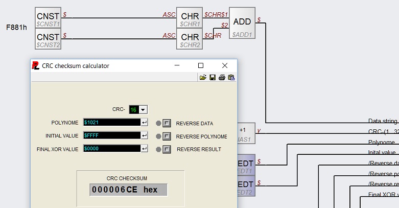

I have purchased a controller that requires a CRC to be generated as part of the communications. I have never come across CRC's so am having a difficult time getting to grips with them, but seeing there is a CRC generator in profi this will assist greatly.
I however am having difficulty getting it set up correctly.

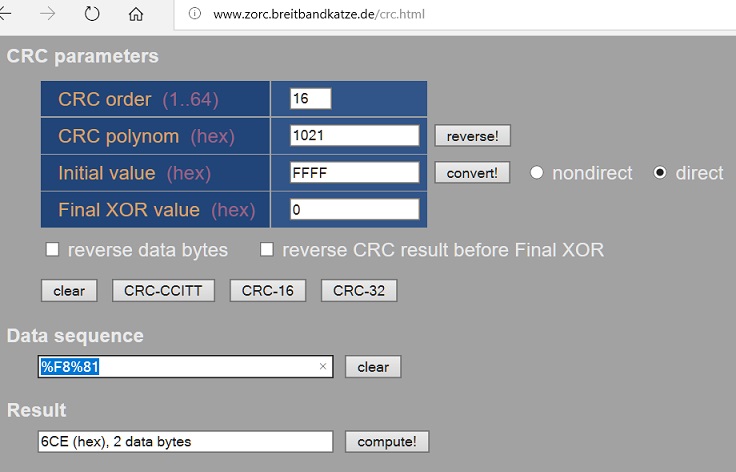

Using an example of "F881" as a data string to send to the device and CRC-CCITT (X16+X8+X5+1 or 1021), most calculators including the linked one on the profi help (http://www.zorc.breitbandkatze.de/crc.html) come to the CRC 8F4F with initial value and final value set at 0. If i type this exact info into profi's CRC i do not get the same answer. Can someone please assist and tell me what i am doing wrong?

Beitrag von abacom » Donnerstag 18. Oktober 2018, 11:35
CRC-CITT (to my knowledge):
Width = 16 bits
Truncated polynomial = 0x1021
Initial value = 0xFFFF
Input data is NOT reflected
Output CRC is NOT reflected
No XOR is performed on the output CRC
CRC-CCITT(F881h) = 06CEh
Two-bytes-datastring needs to be generated! (You can´t simply type in!)
Width = 16 bits
