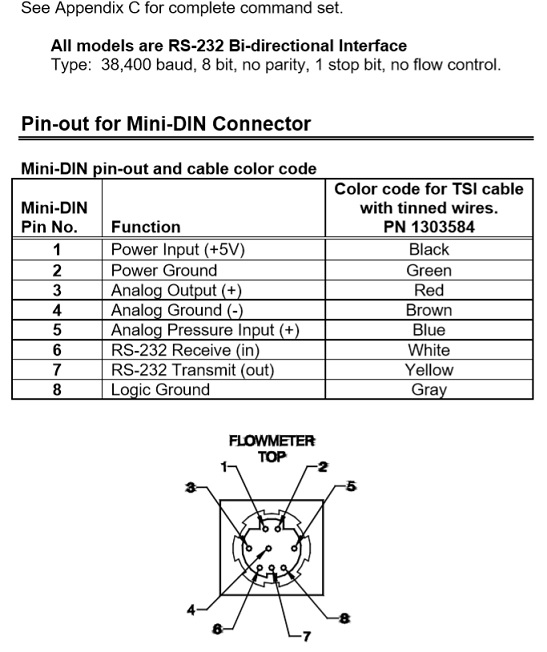

Now I want to encorperate a TSI mass flowemter (4040) into the system to obtain readings from this also, the TSI comes with two cables; currently we use a mini-DIN to 9-pin D-sub connection to transmit data, and use specifically designed software to configure the flowmeter however, there is also a analogue cable with leads as shown below:
1. Power Input (+)
2. Power Groung(-)
3. Analogue Output (+)
4. Analogue Ground (-)
5. No Connection
6. RS232 Receive (in)
7. RS232 Transmitt (out)
I have been advised that the RS232 connection would probably be the best way to obtain data from the flowmeter and simply use a USB com port to link this into profialb.
I wondered if anyone had any advice on what to do with this setup? Am I best using the analogue signal and running this through the ADC converter or am I best attempting to utilise the RS232 connection in some way.
Any help would be much appreciated,
Many thanks, Nick

@Nick,
in the TSI4040-Manual it states:
- analoge: to obtain the measurment (depending on setup of device)
- RS232: you'll be able to fully control the device, which means in detail:
1) you are able to set the device up (as needed), as well as
2) to read the obtained values from it ...
This is the more versatile option. (No external setup utility required.)
The Abacom ADC is not directly compatible with the output of the TSI:
- ADC range = 0.0 - 4.095 VDC
- TSI A-range = 0.0 - 10.0 VDC
(I didn't read about the other device your've mentioned in your post.)
Therefore I'd use the RS232 option, by employing a suitable USB / RS232 converter.
IMPORTANT: it has to support VCP (virtual COM port)

I have been advised that the RS232 connection would probably be the best way to obtain data from the flowmeter.
Yes, that´s what I wrote in my email. I´m still convinced this is the right way. This is the protocol you gave me...
