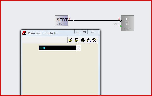

Here my Profilab circuit ,but nothing appear ...
Can you help me ,or send me one way
Send carater chain in serial port to 4 x20 lcd

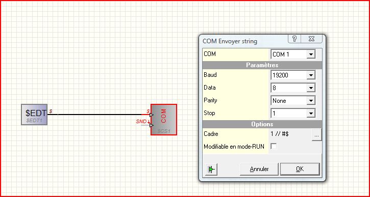

- here the configuration com 1 panel
- try to send caracter.JPG (27.05 KiB) 7379 mal betrachtet
- here my testing project with "TEST" data
- send caracter.JPG (64.96 KiB) 7383 mal betrachtet

Why you didnt connect the send Input??????????????????????
Try this.
This is sending line number and text without any other characters between. If you need a Space between, take a $CONST and change $ADD to 3 Inputs.
Try this.

Re: Send carater chain in serial port to 4 x20 lcd
IT'S WORKING SO GOOOD !!!!!
I'm so very far to take the good solution !
Yes , I forgotten put the send comand, but it was just one timer generator .
I try use other fonction ,with octet input sending ,or using ascii convertor, but the builder of the hardware and software had created the µc for receive direct character sending ,
You don't know ,this post can help me so good in the continuity of my devellopement !
In past i test I/O hardware for relay or contact input not other .
I'm so very happy !!!!
Thank you very much Kaktus !!!!!
