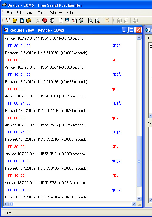

So in a moment Read inputs command is '255 128 00' ("FF 80 00") and microcontroller send back '255 128 xx xx' where 'xx xx' are status all 16 inputs in BIN format. '255' ('FF) - all inputs are 5V, 0 inputs are 0V.
I attach project in working state. Also screenshots Front panel and log serial communication.
