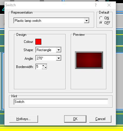

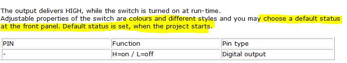

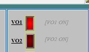

Please help me understand I have various digital controls on my Front Panel the default is set to off
In my understanding from the help file the controls should be off when the program starts,however with me when a user leave a switch switched ON and then close the application
and then restart the application again the Button is the still ON which can cause some serious accidents on a system that it controls as the system starts up not to a defined state
Please help me to understand this behaviors and how to ensure when the user left a button ON and closed the application to ensure that all controls startup in the OFF state please see below
screen prints
Any help much appreciated

Hej,
in the properties of the front panel is a check box "remember last settings". This overwrites the default settings.

Dear Mike
Thank you very much for your help now it is clear and working Thank you again very much it is highly appreciated
