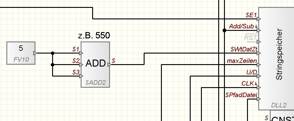

I did this for my own use, but share it with you, 'cause it could suit needs for others, too.
As you might have noticed, PL lacks from a table entry functionality.
So line by line or as in this case, string by string must be merged into some storage space somehow.
Using a file has the advantage of nonvolatile storage.
kPaul has created a DLL some time ago, called Stringspeicher, which is a string line-by-line-to-file-storer with the capability to edit the file to some extent (erase last line, reset file).
This suits well to my need.
If it should be necessary, the file can be edited externally on the fly ! Changes are reflected in the running PL application if the file is stored from a text editor.
In order to show the flexibility of mixed string/value capability, I have provided numeric and string readout fields.
I simply use RDline to peek out one line out of this file.
As kPauls DLL provides kind of 4-line browser, I have added some logic to autopeek a line which was browsed to. This allows to recall a previewed line without pressing an enter key. The peek line is entered after a delay, this allows to quickly browse through the lines without entering data too early.
Other potential application:
Of course the peeker could be used directly (by directly pointing to a line).
If a sequence of pointers was used to adress the file lines in sequence (in the RAM or ROM), kind of real value or string RAM could be realized by this.
The functionality description of Stringspeicher is found elsewhere in this forum; I have added kPauls help file here too.
I have limited its function to fixed max. line capacity (30000) and fixed date/time stamp enabled.
The strings are delimited with <space>. The filepath for Stringspeicher must be set to suit your needs.
The number of string entry "cells" is not limited, I have implemented an index plus 4 entries by now.
The PART function must be adapted, if more cells should be used, or if date/time fileds are altered.
Have fun.
Thomas

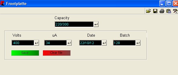

WoB is almost perfect, I just need to save to disk what I write in the tables, and then call the table capacity saved files.
here is the example
thank you very much
here is the example
thank you very much
- 2012-10-22_135439.jpg (25.18 KiB) 179627 mal betrachtet
