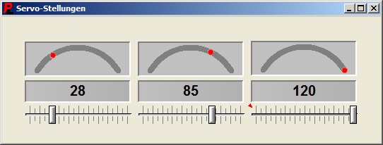

Hallo TOURNEUR,
you can use the MGR.DLL and take a look at the example servo.prj.
(with the scale s-servo.bmp and the pointer z-servo.bmp)
Download: http://www.bkgmx.wg.vu/PL4/MGR/index.html
See also : viewtopic.php?f=43&t=1366
BKGMX
BKGMX
- The example servo.prj in Run-Mode.
- Servos.jpg (29.24 KiB) 14789 mal betrachtet
