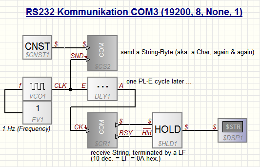

Verfasst: Samstag 31. Dezember 2016, 00:29
von IKT
Not certain to understand the problem correctly ...
A simple COM send / receive String (base cirquit only) see below:
Re: Send receive uart problem
Verfasst: Montag 2. Januar 2017, 19:21
von TOURNEUR
Thanks ,for your help IKT
But unfortunally ,it's doesn't work ...
I ask myself if string com ,recognize HEX format ,
When i use octet com ,everything coming into my com port appear on the virtual pin ,without any synchro bytes.
But the protocol which i use ,employ the HEX format .
With the string com ,I have ASCII to CHAR converter ,CHAR to ASCII converter , but hex is different to CHAR or ASCII .
It's my proper thinking ,but I can do an error ....
I don't know if COM value can receive directly hex format .
The synchro byte which give me problem too ,
With octet com, no synchro byte needed ...

Verfasst: Mittwoch 4. Januar 2017, 15:02
von IKT
Hi TOURNEUR,
my conclusions, so far:
1) you can't use "String" to send, you'll have to use "Send-Byte(s)" or similar. (the same goes for receive ...)
2) PI in Manual refers to "Proportional Integral" Filter (not related to math. PI = 3.1415...)
3) you can use Byte(s) as decimal or hexadecimal (as you like, just: don't "mix" them).
Details of each command, are explained in detail, in the Manual.
Good luck.
