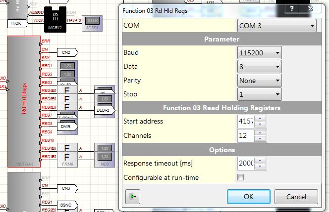

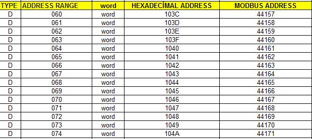

- read holding register and comport settings
- 1.JPG (64.85 KiB) 3362 mal betrachtet
Re: function 03 holding register read problem
Did you follow "Müllmann"s advice? Addresses may be "1"-based or "0"-based unfortunately, which quite often leads to confusion. Latest update installed?
Please try 4156 and 4158 and then come back with your report.Try the register n-1 and n+1 of actual number n and compare the results.
